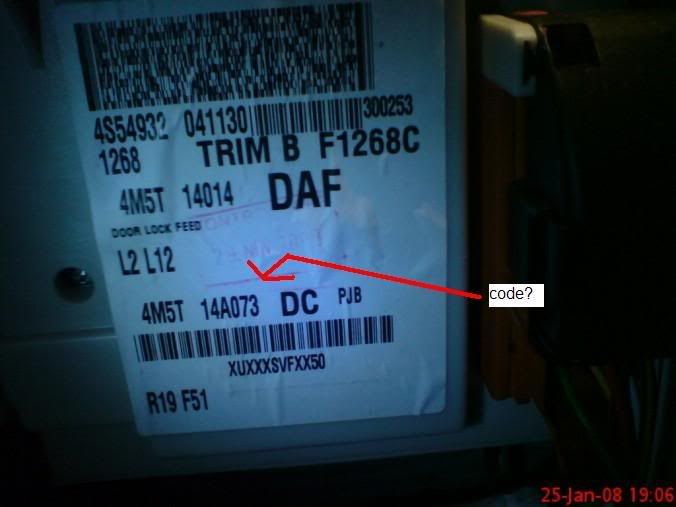

原廠的定速的功能要看PJB 是否有支援
嗚嗚!!我的是CH結尾
不一定有支援定速!!
PJB( power junction box ) is the fusebox behind/under the glovebox
                                I believe the part number on the box needs to end in a Dx where x is any letter.
Possibly a Cx box will work but i'm not 100% sure on that.
Ifyou look at your PJB and find the label and look at the last twoletters and the first letter begins with a D your in luck as that forall service's
So I'm guessing looking at this label from the PJB that I have the one with all the services?

Where is the PJB label ?
Could you show that?
Thx

lintote 發表:
Could you  ...
PJB 就是室內的保險絲的盒子壓!!
在副駕駛座位腳踏板上方
標籤就在盒子上
我的PJB

devilhsu 發表:
PJB 就是室內的保險絲的盒子壓!!
在副 ...
可以在清楚一點嗎?

看一下你的使用手冊!
找室內保險絲盒的說明,應該會告訴你他的位置
oph2004 發表:
可以在清楚一點嗎?
