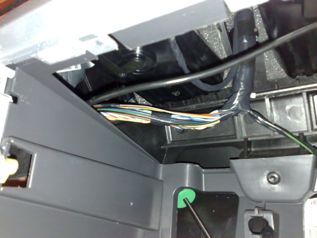

the green markings are torx screws that need removing and the red arecovers that have torx screws underneath. Just pull the covers free butnot to hard as they break easily away from the dash
2. Feed the sterio loom out the top half of the sterio area intothe glove box area and connect it to the relevant end of the bluetoothloom. Now feed the new sterio end into the sterio area via the bottomarea

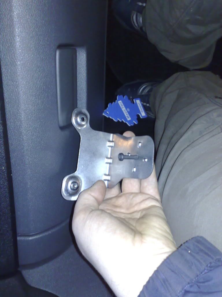

4. Screw the bluetooth unit to the bracket and plug it in to the loom.Once connected bolt the unit in to the car. This for me was prettydifficult as i have big arms    but do able if you feel up behind the dash you will feel the two mounting points the bracket screws in too
